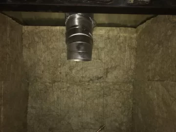

I just installed one in my Fireplace, and I heavily insulated it. The plate barely gets warm, galvanized is fine. What did the sweep suggest using instead?
