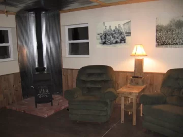

Would like to fabricate a half round shield for single wall pipe out of galvinized corrigated tin. Would paint the outside black and leave the inside alone. The research that I did on galvinizing seems to indicate that anything above 700 deg. will give off fumes.
Shouldn't see those temps on the shield but anyone see a reason not to do this?
Thanks

I agree that a shield at 700 deg. means that your flue is going into melt down. The distance can be what ever with spacers. Was thinking of 1" or less. I like the idea of leaving the inside of the shield shiney to reflect the heat. I have unpainted corrigated on the install of my shed, it never gets very warm to touch when the Mama is really going.
Any thoughts?
Thanks

I think you will be OK, the fumes would only happen if you had a oops moment and airing the house out should not be a problem.
Chimney fire would be bad but they are bad news any way (fumes from galv would make it worse)
Me myself and I would not use it, probably not worth it and I am sure if you have time you can find non galv. to do it with for little or no cost.
Reactions: Backwoods Savage
Let me add if you went with farther spacing it would be that much better.
"I have unpainted corrigated on the install of my shed, it never gets very warm to touch when the Mama is really going."
Well the proof is in the pudding and you sound confident it will not be a problem so trust yourself.
It's really hard to successfully paint galvanized material in the best of conditions. It won't stick to zinc and the galvanizing process leaves an oily residue. If you do try it, you could try using Stove Bright or some other heat resistant paint.
There may be some priming methods that would help, but I don't know if the primers would take the heat.
In our old Resolute setup I painted a galvanized sheet of metal with white high temp Krylon spray paint. Never had an issue with it. The key is to wipe it down with lacquer thinner or alcohol to get any oils off of it.
Thanks bg. I agree about the paint issue. I painted the fence I made out of galvenized strongbarn panels that I put around my wood storage and never had any issues with the paint. I realize it dosen't get any heat but the paint adhears very well.
So do you think this is a bad idea? I can afford to buy a pre made shield. Just like to do things myself
I'm no expert on galvanized fumes but it sounds ok. Another approach would be to make a wall shield with the metal instead of a pipe shield. This could be easier and faster imo. You could bend a 1.5" leg on each vertical side (and bend a 1/2" attachment foot too), then leave it open top and bottom by an inch. This is how I constructed the wall shield for our Resolute. Painted it with white high temp paint.
