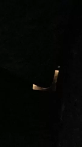

But can it be better? There are gaps where the plate and cap were installed. If I look up through chimney during the day, there is light coming through both the gap between the pipe and metal plate, and between the plate and masonry. See the second picture.
