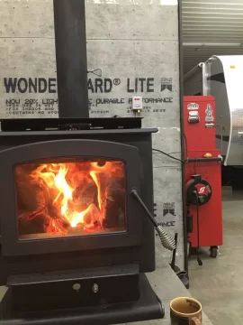

It’s about 20 degrees outside. I have the pellet stove running on 5 in my insulated garage. The garage is a 2.5 car garage. I need to be about 70 degrees, however it won’t heat up past 50 degrees. What is going on?

the floor is concrete! A long time as in a few days of running constantly? It’s been running for 1.5 days now.
Did it work before under the same conditions? If so, then the stove and venting likely need a good cleaning. Other than that, yes even in a house it can take a long time if starting from stone cold. Easier to maintain heat.
we just installed it so I can work with epoxy in the cold weather. But it won’t get up to the 70 that I need.
we cleaned it when we installed it. It’s been running for 1.5 days now and the garage is still only 50 degrees.
Tell us about your stove, e.g., make, model, and year. Maybe it's not big enough.
It’s a countryside multifuel burner, we weren’t given a ton of information on the burner, it was sitting in my father in laws shed and he didn’t know much about it either. [Hearth.com] Garage won’t go past 50 degrees

That stove look like its been rode hard and put away wet, give the heat exchanger a good scraping & wire brushing while cleaning it out, and you will want a OAK to retain the heat made and not draw in epoxy and acetone fumes to the combustion chamber, and you will want to keep an eye on humidity if your working with clear epoxy so you might aswell heat the shop all winter.
+10 on that. Rode real hard from the looks of it and probably filthy inside and out.
