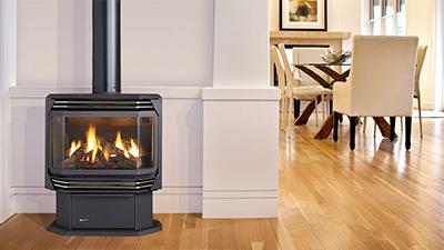

The maximum BTU I am finding is a Lopi cypress bay with 40000BTU or a Regency U39 with a 38000BTU. Will this be sufficient for a first floor of 1250 sqft which is already being heated with central heat?
The two highest BTU gas stoves I am finding are the following. I have a 1250sq foot first floor space. The first one is 40kBTU and second one is 38kBTU. Is this level of BTU sufficient and is a 2kBTU difference between the two above material? Also how are efficiency ratings and heat related? As an example it a 40Kbtu has 70pct efficiency would I expect a 40kbtu heat or 28kbtu heat?
Stoves are rated by BTU INPUT. That number x the efficiency = BTU OUTPUT
40K x .7 = 28K. 28K is the heat you will get.
Whether or not is adequately heats your area, will depend on the amount of insulation in the
walls (& ceiling). If you have central heat, you can get a smaller stove.
If your central heat goes out, a smaller stove may not heat you...
I believe there is conflicting information on this. One of the hearth professional told me that the device will deliver the rated btu and we should not be multiplying by efficiency rating.
