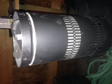

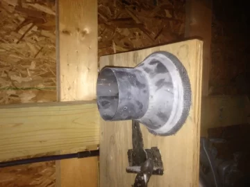

I bought a gas stove off craigslist and he gave me some venting pipe with it. The pope is interesting to me, it come out a 4" and empties into a 6". He said it gives out extra hear this way? It seems like a factory setup, but I'm new to gas stoves. Can I continue with 6" till I exit the house then step it to 4" with the adapter he have me? I'm adding a couple pictures if they will upload, so you can get the jis of what I'm talking about.

What Type of stove did you get? Make & model #? Did you get a manual?
Yea I did its a dutchwest 28000 btu......The manual say for model# 2465,2466
How are you vebting this unit? Horizontally or vertically?
If I can vent it right out the side of the house that would be nice. I wasn't sure how I would do that with the 6" off the top like that. Otherwise I was gonna vent up 6' then out the house then up another 16'.
According to the way I read your manual, If you vent it horizontally, you can only use Simpson Dura Vent & cannot use the B-vent adapter. Others may chime in here if I'm reading the manual incorrectly... I've never seen a combination vented unit like this...
By b vent you mean the adapter? The guy I bought it offer made it seem he was venting right out the side of the house. He said he gave me all his pipe minus the vent on the house, I just want to make sure it's safe.
