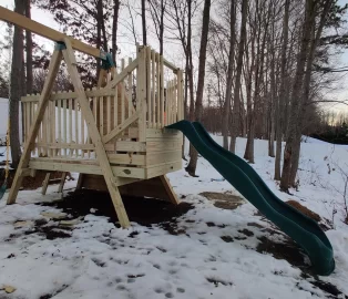

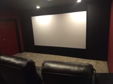

Thank you for that response. I have the tools available and have done a lot of DIY work including the following attached. The primary reason for success for these projects was someone guided me online and I just followed their direction. I am confident of doing this myself but am tripping up on the following questions. I may need some guidance if I decide to embark on this.
1. How and at what steps do I handle the permit process?
2. How difficult would it be to make a large hole through the siding and take the vent pipe out? I don't know if I have the tools for such a large hole.
3. Can I do framing on top of my wood floors? How do I do so without damaging the floor?
4. So far I have only seen you respond to questions. Would it be ok if I could just enlist your assistance for guidance or do other people post here as well?
These and a number of other questions.
