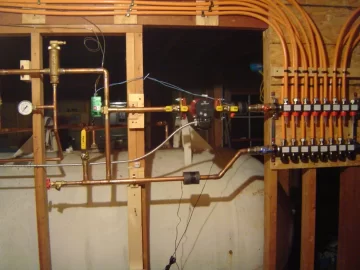

I am using a Taco ivalve(3 way) with ODR to control supply temps to my radiant floor. With ODR, the ivalve is constantly changing the supply temp based on outdoor temps. The colder it gets outside, the warmer the supply temps gets and vice versa. I am using this with constant circulation as well. I really love my system:)

Here is a pic of the heat distribution side of my system. Storage acts as a hydraulic separator with the boiler only feeding storage.
