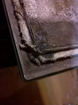

The season wound down months and months ago and I have yet to seriously clean my stove. Here is my (rough) timeline of events, then question.
Stopped burning - left ashes. Took of lid of stove to look around, check flue pipe going to wall and learn a little bit.
Put lid back on, began to start a fire. Smoke was coming out around the lid. Turned the lid the other way to see if the gasket had been imprinted at a different angle, still smoked. Refit, refit, refit and got smoke every time I tired.
Took wood out of the stove. Brused some of the sides with grill brush. Took top off, took second plate out, set to the side. Vacuumed out the stove bottom to remove the ash and all of the sand. Left stove open - it is in a basement with AC, so humidity controlled. Stopped up stove flue outlet with insulation.
Went down this evening to find out what I needed to get to replace the gasket. Would like some input/suggestions/wisdom.

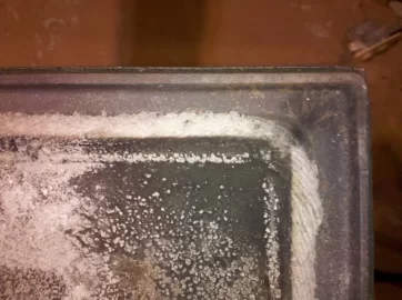

Attached are two pictures of what I found on the bottom of the lid. Can someone point me to good products to purchase to replace the gasket and how I know what 'size' and 'shape' gasket to get? I fear this gasket has been in there so long that even if it HAD BEEN round or squared at one time, I'd be unable to tell now.
1. Can someone tell me what they recommend on replacing this thing and what brands of stuff to use?
2. Need I worry about particles when brushing the rest of the stove clean?
3. Is there something to condition the inside of the stove with to help it last any longer - I can't imagine what, but then again, I aint' so smart with metals.
Thanks everyone!!! Looking forward to a new season!

I don't know what size gasket that takes by heart. But when I've changed them in the past I've had luck going to a stove shop that sells that brand stove and asking them. If there is any question then I pull out a piece of the gasket from my pocket (they get that a lot) and the experienced eye (if you can find one) will usually set you up.

My bet is 3/8" gasket. Its the most common. However i just regasketed a newer jotul and it had 3 sizes. However any major pieces, like your top, were the 3/8".
Hope that helps good luck.
I am not sure if it is an asbestos gasket or not. Jotuls, along with other stove manufacturers, were still using asbestos in the 70s. Either way, I would wear a 1/2 mask with P100 filters, wet down the gasket with soapy water in a spray bottle, do the removal outside, and bag and seal it for disposal. Safety first!
