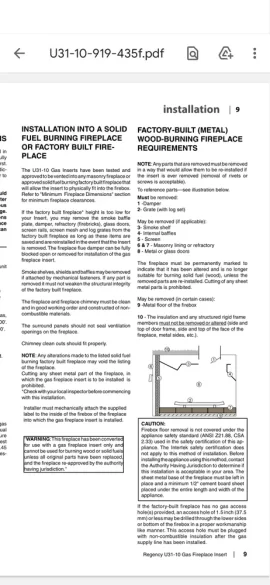

I disagree with your interpretation of product listings. Here is the documentation from the insert manufacturer stating the insert is tested and listed for the manufactured fireplace, not visa versa. And they spell out how to bring your gas in. Agreed the electrician botched that badly.
But one ul listed appliance cannot over ride the instructions of another. That simply is not allowed. Code states all listed appliances must be installed according to their listing requirements. Not just the ones you feel like following. This is backed up by every applicable professional training or certification organization.
It also says the insert can be installed in any approved factory built fireplace. Does the manual list the fireplaces that are approved?

And one that if done in a fireplace which says no inserts are allowed is completely against code. Again one manufacturer cannot give you permission to modify and ignore another manufacturers instructions.
Installers ignore lots of requirements all the time that doesn't make it right. And it doesn't mean that insurance will ignore a code violation just because everyone does it. Or the inspector missed it.
