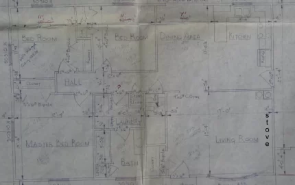

I will post my floor plan anyway. As you may expect there is an "air dam" so to speak above the opening from the living room where the stove is to the kitchen/dinning room area. My thought was to put a hole with or without a fan near the ceiling across from the stove to allow heated air into the kitchen side. I know from talking to others that sometimes air movement seldom works the way you think it would.

The living room is off on an "L" which complicates things a little but the principal is the same. Before poking holes, next fall take a simple table fan and place in in the dining area, on the floor, pointed toward the stove room. Run it on low speed. You will notice quite a difference in about 30 minutes. The living room will be cooler and the kitchen/dining area will warm up.

That's a hard layout to heat.
+1 on what begreen & Dix said.
Definitely try the fan first.

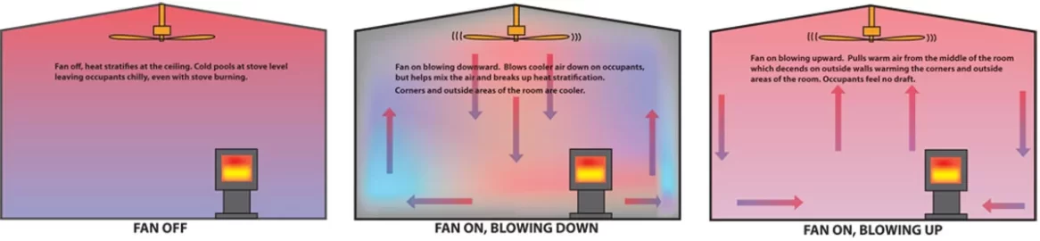

Normally I would do just the opposite Dix. Air blowing down will feel cooler even though it may be warm due to the wind chill effect on skin. This feels great in summer but drafty in the winter. With the fan blowing upward in winter the warm air will descend on the outer walls helping them feel warmer while keeping the room draft free. YMMV.

Welp, I just reversed every one of 'em.... we'll see ;)

More comfortable/even temps with it running in reverse? The dogs won't be interested unless there is a rat or squirrel on the fan.
Mine is down, takes that hot air and blows it down, feels like a hair dryer if I put it on high, people are taking off coats and such (which is nice :) ), like i SAID you gotta experiment with it to see what you get. I dunno about the science behind it, but if I take the IR gun to it everything and everyone is definitely warmer.
