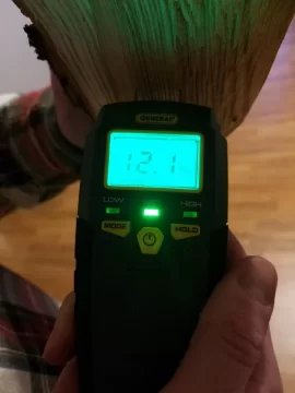

I've been using a mix of mystery wood that came with my new house and some ash I bought off a friend yesterday. He said the ash is 2 or 3 years seasoned (which I've heard is plenty). Split one apart and tested with a moisture meter - tested at 12.5%. Wood is definitely dry. I'm a little stumped on why there's not a lot of heat output and more smoke! I'm not sure if my stove is EPA certified. It has a removable baffle plate on the top with holes in it. I get good secondaries during the entire burn. I just seem to have to run with more air to get the heat and no smoke.

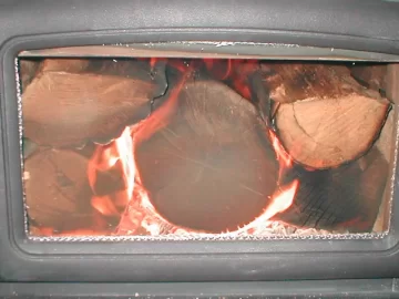

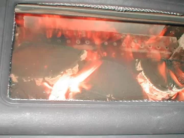

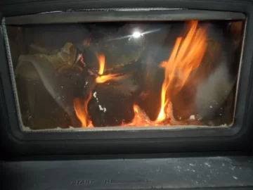

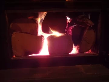

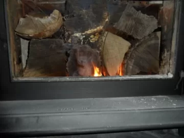

I am attaching a few photos to give you an idea of a full load, or at least what is a full load here.

You definitely have an earlier version of the A body. My A body new in 2006 had the wooden handle painted, as all have been since. Your natural wooden handle is an indicator of at least a pre-2006 model.I don't know when they started painting them exactly.
Thank you! I'll try to give her a beefier load tomorrow and see how that goes. Then maybe it will all come together! The wood I have is predominately ash, measuring around 12.5% on the moisture meter. Guy I got it from says it's either 2 or 3 years seasoned.
It's only seasoned from the day it has been split. If it was sitting around in poles or rounds, that don't count towards seasoning. 12.5 is great, but hard to fathom, especially due to the swampy summer this year.
It was split 2 or 3 years ago. The source was a friend, not some dealer. I split a log and tested with a meter on the fresh split part.
