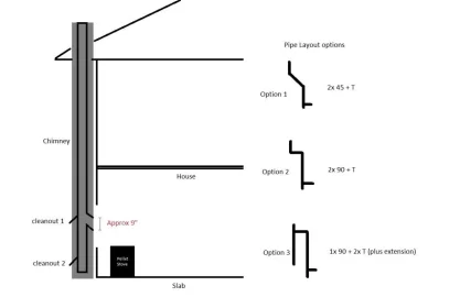

I have an exterior block, clay lined chimney. There are 2 clean outs, 1 right at the back where it enters the house, and another 3' down from there (all outside). So I was thinking about running the liner down from the top to where it enters the house without a clean out, 90 degrees to the thimble, then into the house to another 90, down about 2 1/2 feet to a clean out T then into the stove.
Would this be too difficult to clean out? I was thinking about a T in the chimney but would have to extend the bottom clean out a few feet just so that I could reach it. So would a vacuum hose from behind the appliance, up a few feet be able to do the job well enough to keep this safe, or will I regret putting this all together and wanting to change it down the road.

Sounds like a good plan. Won't be difficult to clean, espec if you break the pipe connection at the wall thimble and sweep upwards through the liner to the top. Take the inside pipe off the back of the stove, take it outside and clean. Sounds like the way to go for me...

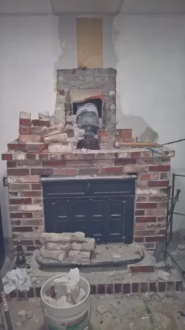

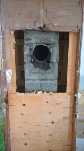

This will be installed on a grade level slab in a tri-level. I have an exterior chimney that does nothing right now. I ripped out the stove they installed and encased in brick along with the thimble which was a mass of brick with a clay liner into the house.
It still looks like photo (after stove/brick removal). My other thought was to install the liner to a 45, straight pipe into the house, and then another 45 down to appliance with a T.
Option 1: seems to be the best but then I have to figure out how to handle the pipe into the house, surround with durock? and how to handle trim on inside.
Option 2: simple use a thimble, could take longer to clean out.
Option 3: simple again with a thimble, just dealing with extending t down to clean out.

Ok, I have decided on option 2, and just removing the pipe when it comes time for cleaning. Seems like sound advice and even a picture of that configuration in the pellet stove manual.

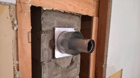

Got the thimble done this weekend. It required me to use concrete to build up the massive hole in the chimney and I used silicon and Tapcons on the thimble on the chimney side. The appliance connector that came with the flex line fit right inside the DuraVent pipe perfectly. I sealed that connection with silicon and screws. Glad the hard part is done.
