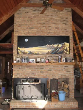

I've been heating with wood for the past 26 years ever since moving to Western North Carolina from Florida in 1987. The first 15 years I used an old Birmingham wood stove (Atlanta Stove Works Woodsman model). Then when my wife and I moved to a new home there was a Woodstock Classic in the lower level of the house and an old dragon breather insert installed slammer style in the main living room's large fireplace. Here is a photo of that insert:
[Hearth.com] Getting ready to install a Jotul F 600 CB with chimney liner
I recently decided to replace this insert and do a proper installation with a flexible ss liner inside the 13" x 18" tile flue liner. At first we were thinking of another insert and liked the Jotul C 550 Rockland CB. While doing online research I discovered hearth.com and after reading hundreds of posts I changed my mind and decided to go with a free standing stove set on the hearth extension in front of the fireplace. We decided to go with the Jotul F 600 CB since we have about 2400 sq. ft. of home to heat (1500 on the main level and 900 on the lower level where the Woodstock Classic is located).

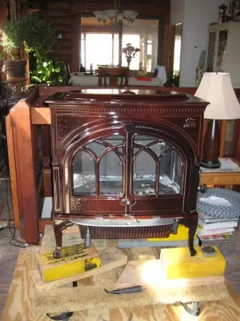

I borrowed a friend's pickup truck and hauled my new stove home yesterday and with the help of a friend we managed to get it off the truck and onto a furniture dolly and then into the house. We had to slide the pallet and stove down a ramp off the truck and then up another ramp to climb two steps into our back screened room. Once inside that room we managed to get the stove off the pallet and onto the dolly with blocking to raise it up the nine inches I need to slide onto my raised hearth.
Once it was securely tied down to the dolly we moved it outside to a deck walkway over to the sliding glass doors of the living room. Along the way we had to again use a ramp to go up one step. Here is a photo of the stove and dolly finally sitting in my living room waiting for me to install it.
As you can see, we chose the brown enamel finish, which should go very nicely with our brickwork on the chimney. I'll keep everyone posted on my installation, which is going to have to wait at least a few days for some good weather.

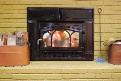

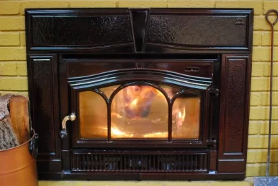

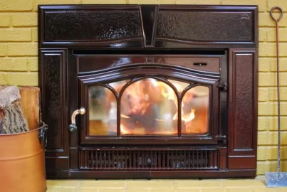

That is a beautiful stove! Good luck, and be sure to post pictures of the install. Wish I had room for a free stander, I have the insert in that color. Be careful, it does chip. Motivated me to take some pictures, can't quite appreciate the beautiful secondaries in still shots.
I'm more of a free stander fan but your majolica insert is sharp looking I must admit, the matching surround really sets it off nice.
