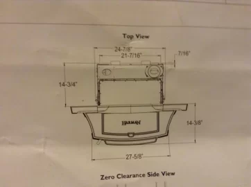

Here are rear dimensions
  • [Hearth.com] Getting The Best Price For A Harman Accentra 52i Pellet Insert

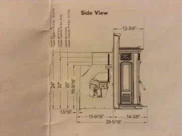

Hope this helps
Hope this helps
A big thanks to you for these drawings. I'll send to my buddy to make sure he takes a look at them. I'm wondering if his measurements were correct. Of course, the dealer did not leave or provide him with the measurements. Does anyone know the reason? Trade secrets? LOL...
U can get those measurements off of harmans web site also just go to the stove u want and click specifications. I just had my harman installed this month with the expensive brown enamel and totall installed was $5200 so if they are charging u that much I would buy somewhere else
