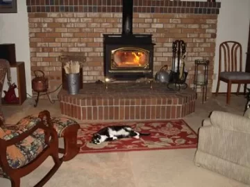

Lopi Liberty in the house with a factory blower kit. We're completely satisfied with it. As for "overnight burns", I really think that has a lot to do with what fuel you have available and just what it is you're expecting. We have access here only to softwoods, and so even with the big firebox, it's tough to have much of a hot coal bed left in the morning to simply relight from. Rick
