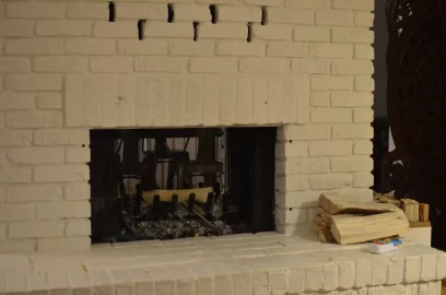

Hi All,
I'm a relatively new guy to the site. I've spent a good bit of time reading threads, but never posted anything.

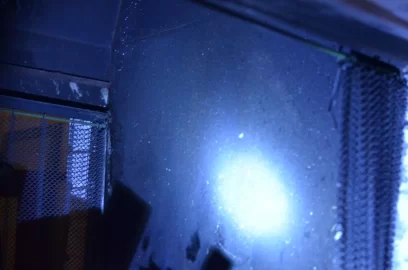

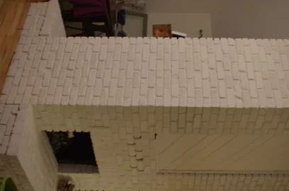

I just bought a house in Southwest Montana that has a nice double-sided fireplace. See pictures attached. We'd like to use the fireplace this winter, not so much for primary heat, but it would be nice not to lose too much heat from this thing. And I just bought two cords of wood, so we'll probably be using it more than when I was doing grocery store bundles.. I've given up on an insert as I can't find any double-sided inserts that would fit (duet is too big, our opening is 19" x 33.5"), and my wife wants to keep the "see thru" option. So instead I've been thinking about installing doors on either side.
Does this seem like a reasonable thing to do? And will this improve the efficiency of the fireplace, or at least reduce drafts? (Or at least let us go to bed before the fire is completely out, which is what we have to do now with this mesh on the front) Any tips on brands of doors? Also, any thoughts on pyroceramic doors that I could leave shut with a big fire? Any advice would be appreciated!
jim

Wives are not always correct (and sometimes hubbies are wrong too). I would put in single sided insert and get some decent heat out of this unit rather than putting cash into doors.
I have a similar fireplace and would do what Begreen suggested but if I was to put doors on I would go with air tight doors like the ones Wilkening makes
(broken link removed to http://wilkeningfireplace.com/ultimate.htm)
Thanks weatherguy and begreen. I think I'll spend a bit more energy trying to convince my wife to go for the insert.
Didn't know about the wilkening doors weatherguy. thanks!
j
The other factor is that we are not 100% sure we will stay in the area, so are hesitant to sink a bunch of money into the fireplace, but would like to get some use out of the fireplace this winter.
