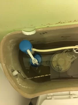

This toilet is less than 2 years old from Home Depot and the flush lever completely rotted off and the chain fell to the bottom of the tanks!

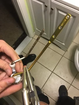

So I bent the shaft and it works! It may even last longer!

Pic 1 - rotted flush lever chain fell to bottom of tank.

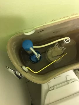

Pic 2 - old broken lever

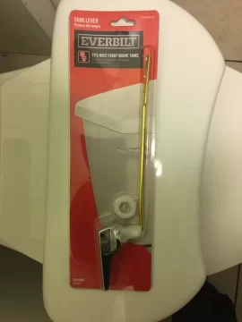

Pic 3 - new Everbuilt replacement flush lever

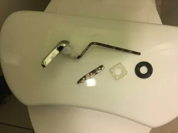

Pic 4 - Bending the new lever vet carefully!!
Pic 5 - Same shape as the old lever and it works!
