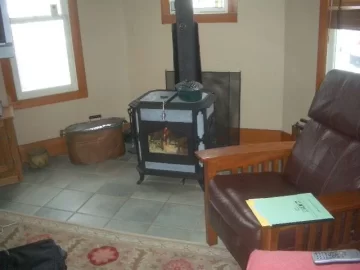

Pix attached. Also two follow up questions...

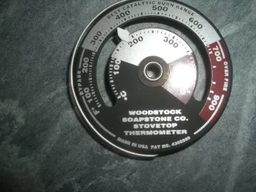

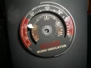

I have done my break in fires and am running the stove to heat the house today (wow, that thing stunk up the house for 24 hours!) I've already noticed that I'll be using less wood when I am up and running next year. I've only had to load it twice in the past 20 hours, vs. 4-5 times with the old stove. However, I see that the flue temps are significantly lower than when I was burning my Vermont Castings non-cat. I guess this makes sense, as the catalytic is taking out even more heat. However, the flue thermometer is at about 200 F, which is below the line that says "creosote". I know these things aren't that accurate and are only guidelines, however, this temperature is about 200-300 degrees less than what it had been with my old stove. So, my question is this- is the 200 degree temp too low? Should I burn the stove a little hotter?
Also, When I load 3-4 logs into the stove, I have to set them all down on the floor since I can't load all at the same time. Setting them down leaves a bunch of crud on the floor that I have to sweep up. Any suggestions on what I can put down to protect the floor and keep the crud from building up? A car floor mat? Would a floor mat melt? I've never had this problem, as my old stove was a top loader and the logs went straight from the log pile outside into the stove. (Top loading was sooooo convenient)
By the way, when I took out the old stove, the flue was clean. Less than a gallon milk jug of soot in the entire length of the flue/chimney (about 20 feet). That was after burning about 5 cords through the old stove this winter. So, I'm convinced that it was burning hot enough!

Wasn't as heavy as we thought- took off the door and firebrick, and strapped 2x4's under the lip of the top edge. I grabbed one end of the 2 2x4's, Vic grabbed the other, picked it up and moved it.
Brute force and sheer stupidity overcome all obstacles
AP neglected to mentioned that he is HUGE from splitting all manner of wood. That certainly helps. Who would have thought that Bob Ross was so ripped that he needed a back up beeper.
He's right, though, not as bad as we figured. Three of us moved it off of the pick up and up 5 stairs. Then AP and I for 15 feet to the hearth.
Ron at Woodstock was very accommodating. I choose stones for the build from e-mailed photos and it came out beautifully. My wife was very impressed.
Last night I burned my first break in to 250 F, which is what Woodstock recommended. This morning's break in peaked at 440 (they recommended 400) with the cat. Not a good smell, but we'll live. I'll post a more complete update after a few more burns.
So far so good.

Looking good,
I won't worry about the creosote cut off on the thermometer with this stove as long as you burn and lite of the cat properly. Those pipe temps sound about right if that is single wall pipe. I usually have a 300 pipe temps with a 600 stove top and 200 with a 400. The internal temps are roughly double the outside temps on my setup. Non cats typicaly burn a little hotter than cats.
As far as the crud left behind while loading, I use a cordless hand held vacuume. Or you might want to look into a hearth rug.

Thanks for the info on flue temps. This thing was running at a cruise yesterday (450 F stove top temp. with outside temps at 30F) and the flue temps never got over 250. Amazing how much heat the catalytic takes out of the combustion gases. As I said in my earlier post, I thing I'm going to see some serious reduction on my wood consumption. I would have gone throught 20 or more good sized logs yesterday, but only burned about 9 or 10 in total to keep similar inside house temps. Unfortuneately, for the remainder of this year, I'm burning some poorly seasoned wood. (25-30% moisture inside splits), so am unable to really get a good feel for how easy it is to run the temps up quickly. I ran through all of my dry wood and am dipping into wood split only in September and Oct. 2008. I have all of 2009/10 wood done and am working on 2010/11 wood now. I've also noticed that the stove easily goes all night on a full load and still has 250 or 300 stove top temps along with good sized coals after an 8 hour burn. I would have gotten heat with the old stove, but not 250 or 300. Pretty impressive.
