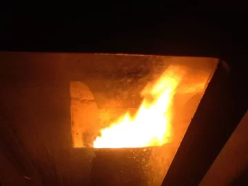

Well I got it welded , and she burns great , nice and blue at the bottom and nice yellowish tips , it's a great improvement, but the amount of heat as compared to my englander is just not there , englander is a 25-ep , blows 200 deg air from the room blower and the golden grain is 160 ish at best , fresh intake is connected and the ash is flying out of the burn pot like crazy, I added a heat sink to the top of the inside of the burn box , it's a sheet of 14 gauge sheet metal hung from the top just under the heat exchange tubs but did no good , it's very clean , blew out the complete stove , used a leaf blower I saw some guy us on u tube , blew it into the fresh air intake from the out side of the house with the stove sealed up, wow , lots of debri , put she's clean , any thoughts guys ? Oh ya thanks for all the dead back and ideas , I'm getting there 1 step at a time!!!
Here are a few pic of the flame , hope it helps [Hearth.com] Golden grain model 2003
