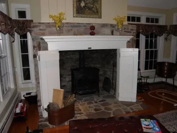

So, I never noticed it looking at them in person, but I noticed a while back in some photos that there's a bit of rust forming on my two stoves. No surprise, they sit in closed-up and somewhat damp old stone fireplaces all summer, doors closed with ground moisture no-doubt eminating from the rubble stone walls.

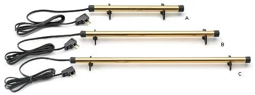

So, taking note from my gun safes, I decided a heater type dehumidifier was a good way to drive out a little moisture (i.e. lower the RH) from these confined spaces, when the doors are closed. I got two of these:

For the record, I did not place the heater rod in the stove, but under it on the floor. My enemy is moisture emanating from the stone fireplace, rusting the outside of the stove.

These things work by simply heating the confined space (i.e. my fireplace with the doors closed), thus lowering the local RH%. Not truly a dehumidifier, but provides the same end result!
how much power do these rods use? how big of a area can a rod do? and how often are they running 24/7?
and cost? can you put up a link to these units?

There are several different wattage models, made to heat various spaces, but I think it works out to roughly 7 watts for 100 cu.ft. They just run 24/7, like the old lightbulb trick. Google GoldenRod dehumidifier, or DriRod.
