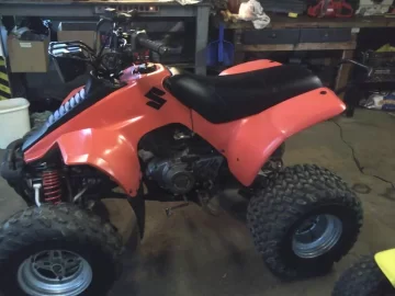

My clean up ritual for saws is simple green, magic eraser and then meguires tire shine.
Works well on 25 year old atvs too :)
  • [Hearth.com] Good engine degreaser?
