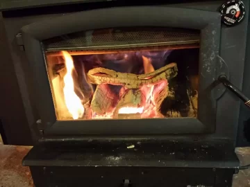

Rather new to wood burners but enjoying it this far. Wondering where to place the thermometer. I have a magnetic one made for stoves that says Meecos Red Devil on it. The stove is a brand new buck model 74. It's got a stainless steel stack so the magnet is useless in this case. The thermometer is currently front and center at the top of the door. I also have an oven thermometer resting on the stovetop. The stove is tucked into a masonry fireplace. I removed some of the black sheet metal backing to gain access to more of the stove top. What differences does this make? Is there a rule of thumb guideline I can go by, or do I have to figure out a way to tie it up with thin wire?

We've since placed it on the metal body of the stove and it's responding reasonably well. From start it takes forever to raise but once It's up it stays there. I've gotten some really hot numbers off of it here. Close to over firing even . I'll check the owners manual, I gave it a fast once over and put it in the filing cabinet for safe keeping.

Is this an insert? Looks like it would be easier to place a 2" dial thermometer there.

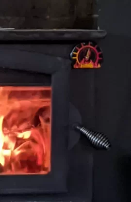

I've had it for 2 years and still working. I have it placed on the face of my wood stove insert. my co-worker who also has one but has the same wood stove as i do but no the insert, he has his on the top so if he walks up to it he can read it.

Yes begreen this is an insert. The thermometer is about the same as a dial thermometer. It's nice to know I'm not the only one placing it on the front face Dave. Just seems like the most practical spot. Maybe I will invest in a cheap but fairly accurate laser thermometer as well. Thanks for the feedback everyone.
We've had this thermometer in the upper right of our Buck 74 for many years.
