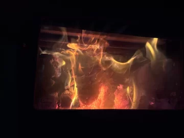

I have a probe in the appliance adapter of a Drolet 1800i with a damper. I can not run it below 650-700. Just won’t happen. Medium it 800. And full secondary is 950. STT never get above 650.
So the answer is a lot. The blower makes at least a 50 degree difference. And almost another 50 low to high (too loud on high).
I would like to know what the temps are 15” above the stove but I’m not drilling a hole in the flex liner.
Data point tonight. Blower on high. Flue temps 700 degrees at the appliance adapter (damper full closed). Center stove top temp is 500. Tubes are glowing just slightly. I call the a medium burn setting. Maybe medium high.

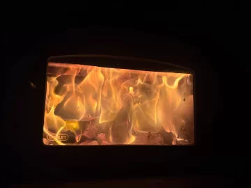

And here is a small hot reload that’s running 625 STT right in the center and peaked 900F at adapter. It’s falling now. Lesson relearned. No hot reloads. I’m ok with these temps when run this way.

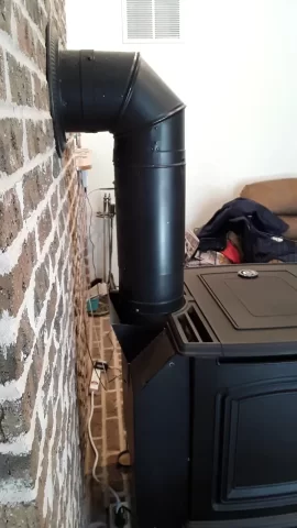

Late getting to this party. My Auber thermocouple is only 13" above the F45 stove top, only 7" below my 90 elbow. 650 flue = 425 STT with air valve closed, boost holes plugged. So no 600 or less flue temp = 600STT
1. There is no doubt in my mind the 90 slows the flow and keeps temps higher in that section of pipe vs a straight up pipe.
2. Only 13" above doesn't help either.
I have considered re-installing my singlewall if I can find it and measuring temps with IR gun.
I think you’re probably right about the 90. Flue temps will vary with different setups and I think 600 is fine for yours. If it was consistently higher in the 700-800 range I may be tweaking things. I’d leave the double wall pipe there. What are your IR external temps before and after the 90?
