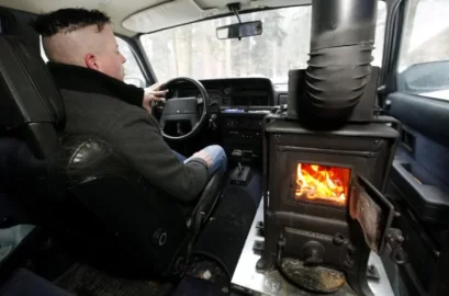

If the temp goes below 10 degrees fahrenheit, use two of these stoves
