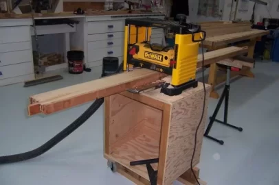

I like mine. Bigger would always be nice but it gets the job done.
Just take small bites with oak & hard maple ;)
