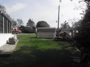

E-bay had a batch of them refused/store returns for $750 free ship. They sold pretty quick. I am dry-walling and would like to get it installed within the week. The park does not allow wood stoves but my landlord gave me tentative allowance to use it as long as no one complains. The neighbor on the right is very nice and is or friend. The neighbor across the way is nasty and vindictive and would complain out of spite. I'd like to keep sparks/smoke out of view as much as possible. The two pictures shows the neighbors and the other is the inside.

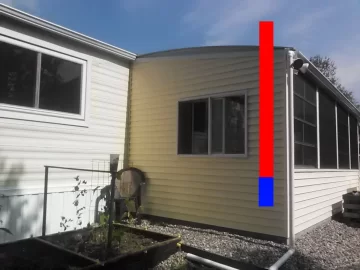

The sits across the outside corner where the yellow potted plant sets. The thimble sets in the bottom.front corner of the back wall. The stove 45's out. I wanted to go 90 under the windows and come up 18" away from the window and shoot out into the hood. Should I come out of the house with a tee and put the 90 on top turn the tee sideways over to the 90 or 90 under the window put in the tee and go up a bit. Is it possible torun the stove with minimal sparks& smoke. I originally had a Summers heat pellet stove at our last m/h that vented straight up into our old wood stove chimney. Hardly anyone knew we were burning pellets Thoughts/ideas ? God bless.

So you want the stove in the corner, where the yellow pot is? If so, put a 45 degree elbow, straight out of that corner to the outside, put a clean out tee and then run the pipe up over the roof if you want to best hide the smoke from neighbors.
[Hearth.com] Got My Castle Serenity - Not Installed Yet - Questions
The blue is the 90 clean out tee, and the red is the pellet pipe.
