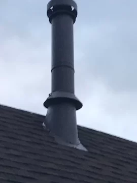

I had an overnight fire and had raked the coals to the front of the stove. It had cooled to the point that the thermometers weren't registering.
I was doing my daily tasks to get the house ready to sell and my wife says "the chimney is making a noise, sounded like stuff was falling down" I thought "Oh no, the chimney will need to be swept". I got over to the flue an give it whack with palm of my hand. Nothing. Then I hear the distinct sound of a bird flapping. Sounded like it was at the top elbow of the flue in the living room, 8 feet down from top of chimney.
So I get my light and screw driver and shimmy out the spine of the roof, remove the top 2' section of pipe and the cap, thinking maybe it will see the light at the end of the tunnel and fly out. No bird in sight. So I go back inside and whack the flue again and got a response. It's sitting on the flue thermometer, 18' above the heater. So I raked the warm coals to the back and removed the thermometer.
I looked through the glass and there set a defeated looking male blue bird staring out at me. Used a gloved hand to catch it, took it outside and tossed it up. He was glad to fly away briskly. After the ordeal, I removed the baffle and about a half gallon of soot had collected on top. Some of it was probably already there. The chimney and flue didn't appear to need sweeping (after two years) so I cleaned the heater, put it all back together and good to go.
So all of this begs me to wonder, does a bird think that a flat brown 6" chimney and cap is a tree? I never had a problem in three years before the roofer painted it without my consent. Maybe a factor it the paint or no paint discussion.

Thankfully, the parts are on order and I will have a non-tree-looking chimney and cap shortly.

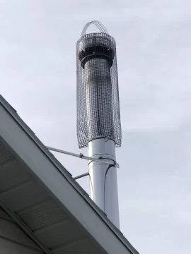

My chimney cap has no screen. I now put my makeshift bird screen it for the spring/summer. Don’t want to see dead birds in the stove. I’ve saved some from the stove but they don’t all make it.
What parts are on order?
