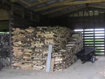

Mine stores two years worth of wood, but I've heard said, in France, that you should store three years - in case you are ill one year. If you are ill for three years its probably Game Over anyway!
My wood shed has slatted sides and is open to the prevailing wind. Thus I don't have to stack (somewhere else) and then move it to the shed for the winter, it stays there from green-to-dry-to-boiler. It has a concrete floor which allows me to sweep up all the "shrapnel" off the floor and use that as kindling - which saves a job as I, now, never need to make / collect kindling.
This is a wood hanger! Wow! Put a Cessna I there too!
