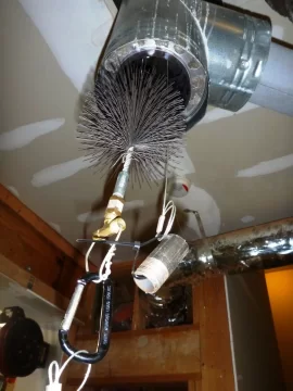

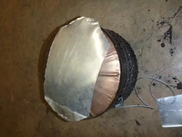

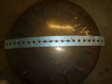

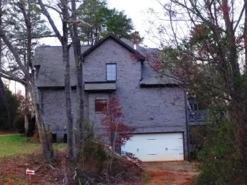

Got tired of climbing the steep roof to clean chimney.
Bspring
Feeling the Heat
Aug 3, 2007
370
Greenville, SC

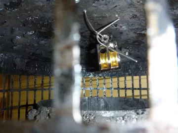

I put some bracing on the top of the cap. Added a pulley for a cable and then covered the top with some flashing to keep water out from the holes. The chimney section that I will clean with this set up is 34' with 2 bends in it. The fiberglass rods would not work. At the bottom I connect the brush and pull it up with the other end of the cable and then back down. I had to really yank on it at the 2 bends and was concerned with the amount of force I had to put on it but it finally went up. For what ever reason it was much easier coming back down.

Yikes, that is steep! _g I guess the resistance of the creo stuck to the inside of the chimney, plus pushing up the stuff that was already knocked loose, made it harder to pull up than to pull down. Why the double pulley? Is that just something you had on hand? Seems like the cable would want to rub on the side of the pulley housing since it will tilt when force is applied, but I guess it worked OK.

So when you clean from the bottom up, how much creo gets pushed out the top onto the shingles? I wonder if that stuff would eat the shingles after a while? I put some roof coating on the shingles around the chimney area back in the day when I had a lot of creo liquid running onto the roof. !!! ;em

I wonder if the heat will weaken that cable after a while?
I got a kick out of the assortment of connectors and whatnot's you have connected to your cable and brush
(brass fittings, twisted wire, carabiner, zip ties, galvanized pipe, etc...) You just need to attach a kitchen sink to one and and you can say you used everything. lol

MacGyver would be proud!;lol

Curious...Is your chimney top 2 feet above that roof ridge? Or is it more than 10' away?
i would think the creosote will jam that pulley as you burned
Hmmm.. besides the fact that your outside section is to short, what are you going to do about cleaning the cap and screen? On ours that is where ALL the buildup is.

I plan to leave the cable in all the time. I will see how it holds up.

I used stuff that I had laying around. The double pulley had no clearance on the side for the cable to slip past the roller so I used that one. It really does not have to roll, the cable will slide over the roller if it gets gummed up. The bends are no more that 45 but that would be a lot of work to push that almost 40'. It was a lot of work even going from the top down with a big weight helping. (lift up and drop down over and over)
I think all of the creo will fall down when going from the bottom up.

The chimney is not of the roof above the window it is on the roof line behind that one parallel with the window. I can't say for sure that it is 10' from the ridge but it should have been built to code. They gave me a hard time on my house. I would be very surprised if they missed that. As for the cap I'm not sure on that yet. I guess I will see how it goes.
