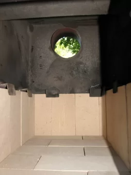

A baffle plate inside is the best improvement and simplest. Did you find the baffle thread? Later double doors had what Fisher called the Smoke Shelf Baffle, but they could only make them so the stove would work with larger chimneys they may be connected to, wasting more heat than necessary up smaller chimneys. Fine tuning a baffle to your chimney flue and connector pipe configuration makes a huge difference.
I run a ceiling fan on low setting all winter, pushing air down. I get much longer burn times and more efficient heat (burn less wood) than if I don't run the fan.
Besides a ceiling fan, and a baffle plate as coaly suggested (it makes a HUGE difference), do you have a stove pipe thermometer?
My baffle plate had to be bigger than coaly's because my Mama Bear doesn't have that nice shelf under the rear vent pipe like his does. So my plate sits on top of a sideways firebrick in the back.
Make a template out of cardboard so you know what size plate you need.
