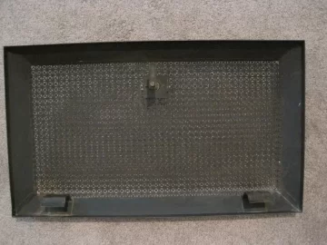

Next to the XL, Grandpa is the most difficult to find. They also sell for close to $200 when you do find one on eBay.
There are three styles depending on the Grandpa year.
The first for the early stoves with round door seal will have a black
frame and the screen will be little + shaped holes with a chrome truck cap type turn handle. They are also collector items, so be prepared to pay.
[Hearth.com] Grandpa bear fire screen. [Hearth.com] Grandpa bear fire screen.
