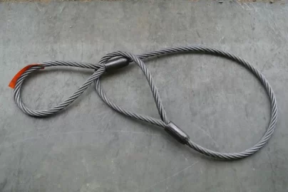

I hate playing with chain. I have a 6' choker made out of 5/8" wire rope/cable. Just get it under a log slip one end through the other end then a snatch strap through that end and pull your log where ever you want. This is not mine but the same design. [Hearth.com] Grapple handling?

I have seen tongs break out and turn into a missile. I have seen more chains break than cable. Neither is fun, exciting but not fun.
I broke a 1" nylon rope while pulling a tree over with a bulldozer. Boy was I glad for the cage on the rear of that dozer which was of course put there for just this reason but still, that rope slammed into the dozer like a missle and it was loud!
I pull with heavy chains and have never broken one. I would like to think that they are the best thing to have break on you.
