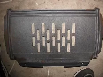

Here is a pic of my spare bottom burn plate.
  • [Hearth.com] Grate for Jotul 3cb
