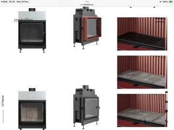

I will inquire and report if the steel panels have insulation behind the steel, as far as I know now there is none. See attached pic (Metalfire), apparently any combination of panels and vermiculite/skamol is available.

The Optimum literature indicates:
A. insulated combustion chamber available with Original, Round, Triangle or Ceramic interior finishes​
It's also catalytic which should make it a cleaner burning insert.

I asked them if there is anything behind the steel panels to obtain that insulation, their answer is that behind the steel there is vermiculite, and that the difference between steel+vermiculite and Skamol is negligible! That sounds good. You can easily exchange the steel panels for Skamol later, if you like.
I like the steel interior protecting the insulation. The interior of the firebox will get occasional bangs from adding splits, especially to a hot stove.
Reactions: rickj
Exactly my idea, I like that too. Here in Spain much of the wood you buy locally is very hard chunks of olive, and unsplittable (by me), and when they fall over… The 20 mm steel bottom plate won’t be backed by vermiculite, but I could always put a plate of vermiculite on the bottom to see if it makes a difference. (Thanks for stressing also the metal version is insulated.)
