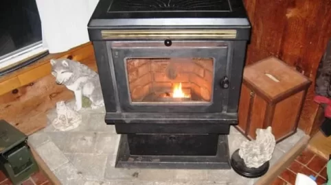

Left there and came home. It was a warm enough day so I decided to give the Enviro a deep clean.
I pulled off the vent, OAK, and the plug from the wall. Using a 2-wheeler I managed to pick it up off the hearth and roll it out onto my front deck.
I brought out the air hose, vacuum, oil, brushes, and hand tools.
Proceeded to pull the stove apart right down to bare bones. I went at it with the vacuum, and compressed air really getting all of it cleaned out.
I wire brushed all of the firebox and combustion vent.
I cleaned and oiled both blowers.
Put it all back together and gave the vent stack a brushing.
Moved it back into place on the hearth and reconnected everything.
It is supposed to get down into the 20's here tonight by morning so I decided I would put the first bag of Okies through it vs. the Premier's I have been burning.
Here is a shot of the hopper loaded with Okies. And them just starting to fire up.
It's been burning about 3 hours now and the house is a comfortable 72.
Man...I love burning in a clean stove.
---Nailer---

The EF2 is a cute little stove. How old is it? First time with the Okies?
Too windy here in Yport to rake leaves. Gotta get out today. Fire is nice, though.
Marina
Jay,
The EF-2 is a 2000.
Freestanding (as shown)
I bought it used from a guy that had it sitting at the end of his driveway for $100.
I have been burning it for 4 years now.
IIRC I have replaced,
Burn pot liner
Combustion Blower
Convection Blower
Auger lower bushing.
Other than that it just keeps burning.
Firebox clean about every 3 days.
Deep Clean after each ton.
I heat a 900 sq ft converted cottage. Open floor plan.
Biggest heat loss I have is a strong Northeast wind coming off the lake all winter long.
The wind sucks the heat off the house.
I burn about 3-4 tons a year.
The stove has had 5 tons of Okies go through it so far.
These were just the first Okies of the season.
The predicted 20 degree morning temps warranted moving from the shoulder pellets to the real winter pellets.
Marina, good to hear from you again.
---Nailer---
