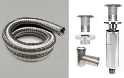

There is a special top plate designed for a flex liner but still allows you to have the airflow needed. Just get the outside measurement of the chimney you have, the measurement of the outer most wall. Ensure the top plate you buy will cover that opening. On the bottom it has a stainless steel screen that still allows airflow between your current chimney.
Thats very cool. I didn't know they made such a thing! Of course that brings me to another question. With that air space and for safety reasons I like the air space. But with that air space would it not pull out hot air from the room? Is it wise to block the bottom off?
Joe
With this top plate, you should not modify anything else in the chimney. Leave it as is on the bottom, don't block anything off.
