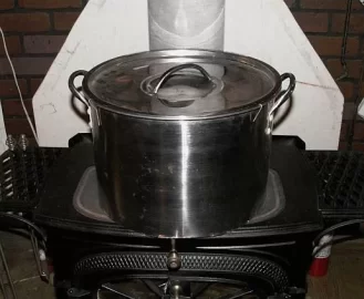

I tried this idea today, The upturned stock pot wasn't adjustable enough. Since it is one of those cheap stainless pieces of %#!! thats too thin to cook in since it heats so fast everything burns in it, and the stainless is so low grade it rusts. Its not even good for boiling water because the handle rivits are some kinda pot metal that dissolve and corrode in hard water.

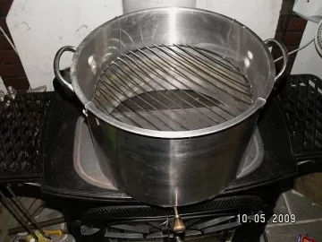

So, I cut the bottom off with a sawzall. I have wire hooks to hold up the round wire rack (lucky find in my junk pile, I'm sure you can buy em somewhere) inside BUT, I'm gonna drill holes down the sides to stick in pegs or nails, so I can adjust the wire racks distance from the griddle surface.

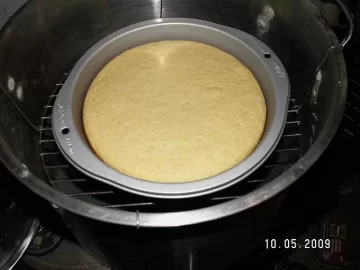

Up high, it bakes cornbread nice and evenly, in about 20 minutes. Down low, I baked a dozen potatoes closer to the griddle, which took about 35 min or so. (didnt time it, I'm guessing..... they were fork-test done however long it took)
Once I can raise and lower the rack wherever I need it, I'm sure it'll bake anything. At the level the cornbread baked good, the oven thermometer I had in there said it was holding about 350F more or less.
with the rack sitting on some canning jar rings, the temp rides around 500. To hot to bake anything, but it does show the range possible with just raising and lowering the rack.
I figure if I put the highest pins a bit higher than cornbread level, this pot oven will have a usefully predictable and steady temp range from 300F to 500F
The highest would bake stuff like cookies or biscuits or light meat like fish, the lowest would fry french fries to a nice crisp or broil meat like chicken or pork chops.
This is P.O.S. SS Pot Oven, Mark 1.
Mark 2 will have an adjustable rack.

The pot is 8.5" tall X 12" dia.
The rack is just big enough to fit in it, I scrapped it out of an old BBQ grill.
The wire hangers are 4" long, but I'm gonna drill holes in it 1" apart down the sides to make it adjustable.

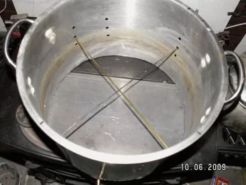

When you drill the holes, maybe make them opposite each other and use metal skewers to run from side to side. Three or four skewers would do it. Check the kitchen gadget area in your local grocery store - they should have skewers that have a circular end and a pointed end (I think they would work great!).

I like the skewer idea. But for now it will work with simple wire coat hanger.
lol
I'll pick up 2 long skewers when I go out tomorrow, they will be thicker and be more sturdy under the rack. Once baking is done, you can pick the whole thing up by the handles and set it somewhere to cool off, with its cargo of cooked hillbilly goodness.
I have to drill a few more holes for the lower setting, but ya get the idea.
Cris-crossed rods, now the lid fits tight.

I'm baking a thick 9" square pan of cornbread now and the new oven thermometer I got yesterday reads 450F in the center rack setting.
If I set it half on and half off the griddle, the same rack level goes down to 325.
So there are several ways to adjust the oven temp..... options are good!
