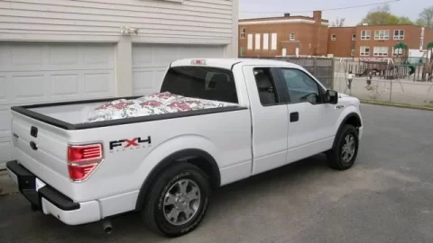

Picked this up yesterday and just got done unloading it...
The coal, 2,400 pounds of it. Takes up less room, burns longer, doesn't make smoke or creosote... and can burn it during 30 degree weather out and don't gob up the works.

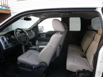

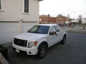

The truck, I picked up three days ago... yesterday the dealership put a "Simonize" treatment in and out, then I went and loaded it with coal.
