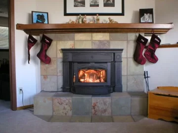

I love my hampton hi300 it's been a major source of heat for our home since october I've cut my gas usage in half it would be more but no ones around during the day to keep the thing fed. And yes they are made by FPI And yes it has looks to kill. I was lucky enough to purchase mine off the shelf at my local dealer this was however before gas price increase anounccement. I emailed hampton about operating temp last week and he got back to me a few days later which was surprizing But did'nt realy give me an answer on shelf temp. probably too many varibles to give an estimate. Iwanted to get a thermo that sits on top but I don't think I will now. About the blower you diffinitly want it other wise your going to have a big empty space at the bottom not to mention not being able to throw some heat of the thing. We have tried to boil water on the top but you have to get the thing pretty warm with the blower off, maybe to warm. If you plan on cooking anything don't count on it theres an inch gap between the top shelf and the top of the firebox where the blower pushes air out. in an emergency I spose you could take the top shelf off and cook on top of the firebox. Otherwise we are very happy with our unit and can't imagine life without it! Also my dealer said that the regencys and my hampton share alot of parts like the baffles and air tubes latches ect.. so hopfully in a few years I will be able to purchase these things.
  • [Hearth.com] Hampton (Regency's alter ego) Insert (HI300)
