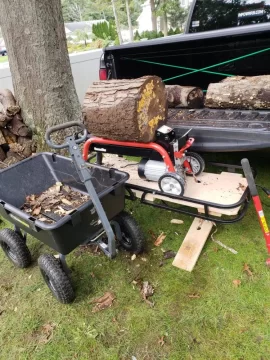

Here's my homelite 5 ton with a cargo carrier from HD. I rigged a simple foot pedal to operate both levers. With the tailgate down it makes for a great work bench.
That looks like a nice setup.
