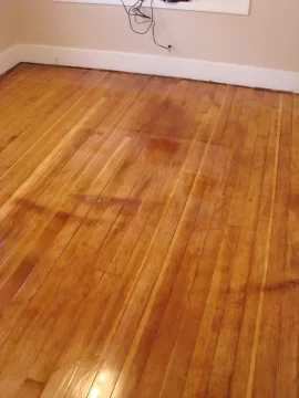

I thought a 4 day weekend would be plenty of time to refinish a bedroom floor.
I rented a sander and started sanding. Well, our house was built in 1922 and this floor must have had a yearly coat of poly for the last 50 years.
The old finish kept gumming up the sander. After fighting this i broke down and got some paint/varnish remover. The results were fair. So i sanded, and sanded.
Finally somewhat satisfied with the sanding , more like "this will have to be good enough". I vacuumed and tack clothed the floor. Everything ive read about applying the polyurethane says use a lambswood applicator. Even the directions on the can. So i did. First coat went on fine. Let dry overnight, this morning i went to put on the second coat and this ******** expletive lambswool applicator shed all over the first coat. I quickly threw it in the trash and used a brush. The brush worked fine but the remnants of this shedding lambswool can be seen throughout the floor finish. I am wondering if more coats will eventually hide most of the sheds. The shedding is clear and only seen on the surface. Any suggestions on what to do here? I think of myself as a pretty handy guy, can tackle most projects with no problem. Ive met my match with this one. Thanks for any advice.

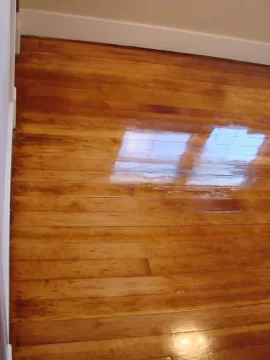

I spent a couple hours sanding with 100 then 220 grit.
I got all the fuzzies out. I will think twice about doing the other bedroom.
In the end i think it turned out pretty well. There are still some light / dark areas and a few light gouges
here and there, but it definitely has character. Thats my story and i am stickin to it.

Looks great, you won't regret resanding, even though it is a pain.
Thanks Webby
dang, that floor looks good! don't be afraid to do the next one, it'll turn at 2x as good due to what we call around my place...."THE LEARNING CURVE"!!!
