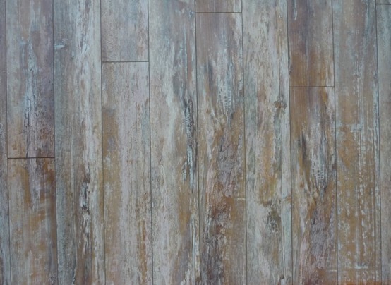

Fooled me!Here is a better view. It's actually porcelain tile! I wanted it to look like hardwood. I guess it worked!
Was almost going to call for a wood ID on it.Here is a better view. It's actually porcelain tile! I wanted it to look like hardwood. I guess it worked!

I figured you were gonna surprise us! My brother used that stuff in his master bathroom and I REALLY had to look at it to see it was tile!Here is a better view. It's actually porcelain tile! I wanted it to look like hardwood. I guess it worked!

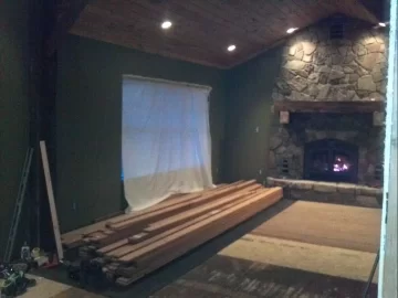

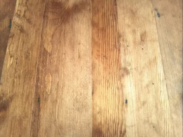

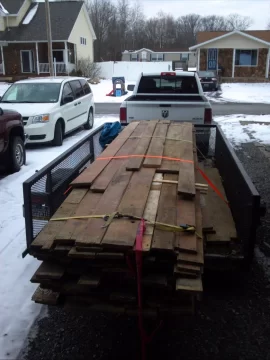

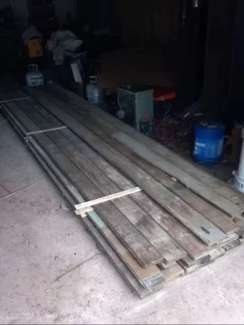

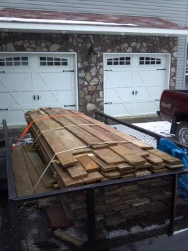

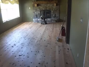

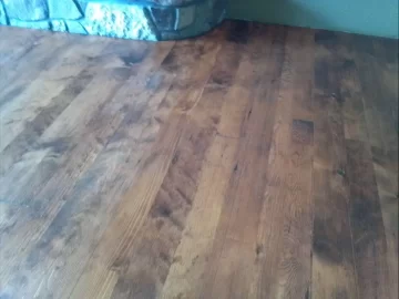

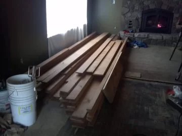

I hear you there! I had to chuckle when I saw your pics as mine are similar. While our wood wasn't wet (it was in dry storage from the time the house was demo-ed until we bought the wood) it wasn't very pretty stuff. All of the T/G was originally done with a hand plane. It was weathered and very rustic, when we pulled in to the seller's place my wife was like "did you seriously pay money for that wood?"
View attachment 106994 View attachment 106995 View attachment 106996
Now, she loves it! It was originally flooring in an 1840's farmhouse, it had the old square cut nails in it. I have over 9 hours with a metal detector and pliers pulling out those old rusty nails. After we planed it and re-milled the tongue and grooves, I installed it and put black wood filler in the original nail holes....then sanded it all down. It looks fantastic with those old square nail holes in it.....really gives the room character. I left it sit in the room (with the NZ3000 burning) for over a month, to acclimate it to the room humidity.
