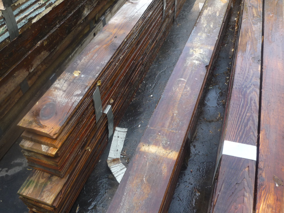

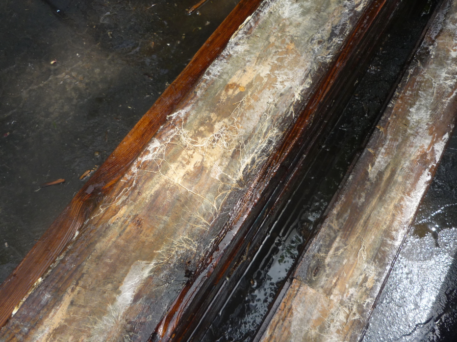

Thanks! They were a LOT of work, when we got the wood it had been tarped for a while and was growing a bit, lol

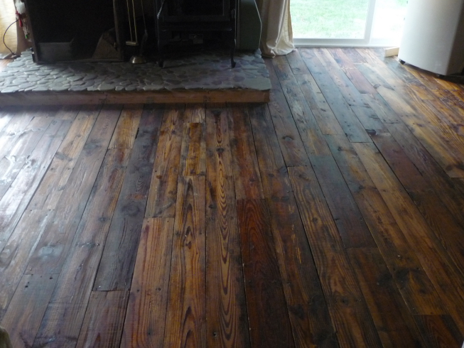

Here are a few pics

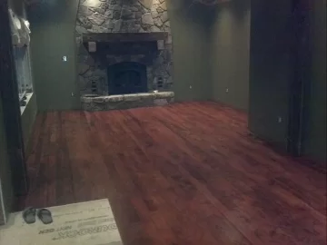

Done:
[Hearth.com] Hardwood Floors?
Before:
We had tile before when we bought the place, but actually the whole subfloor and pretty much all of the joists were rotted to the point of complete replacement-in fact, the original sill plate had rotted into non-existance to the point that a friend that's a contractor didn't believe us at first when we told him there had in fact, been one (until we showed him the remains that had fallen into the cinderblock foundation!). We found the floor on CL, along with most of the old 2x4s (now part of our shed as well as some wood racks) and old siding (sided our shed). It had been taken down with the intent of rebuilding it in a different location about 5-8 years previously, but then the house was sold and the new owners had no such plans.
There are many more pics including the living room rebuild on my blog :)

Is taht floor screw or screw with pegged holes or did you just shoot it with framing nails??? Or are those the old holes from the previous life that i am seeing?
Ooops, sorry, used to the old house folks. BLO=Boiled Linseed Oil.
I mean i know what "Blow" is in the terms of the hollywood types like Lindsey lohan and Gary busey but......haha
oh yea i have heard of that just did not know the ackronym for it.
Hand cut nails, put in one by one mostly through the old holes that were preexisting.
And in case anyone is wondering, yes, they do occasionally work their way up and need to be hammered back in. I'd say maybe 10 have done that enough to need to be rehammered, since we put the floor in a year ago.
I need to reoil it soon, but I think it is more effective in the winter when it's dry. However, it's easier in the summer when I can move couches, etc outside and do the whole room, vs doing it one side at a time (while moving that side's furniture to the other side).

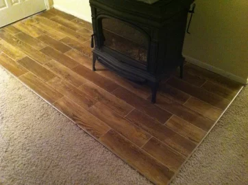

Circa late 1950's - early 1960's hardwood.
No problems with the PE. Murphy, on the other hand is tired ;)

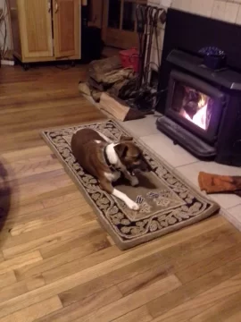

I have mine right on the hardwood, and don't notice any problems. ;)

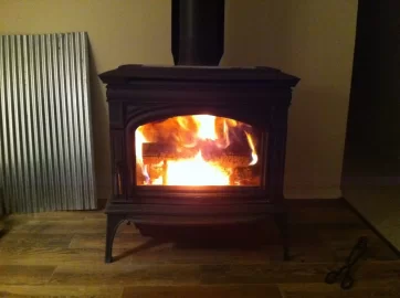

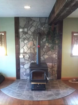

We've got hardwood oak throughout the house, it does shrink just a little bit (maybe 1/16") in front of the hearth in the kitchen......
The antique reclaimed pine in our remodeled great room has yet to be tested with the Napoleon NZ3000 we just finished up last winter....
That is antique, random width flooring out of an 1840's home in eastern PA that I replaned, re-tongued and grooved, and installed in the room. Some Minwax Early American stain and three coats of Varathane Satin.
I can tell ya, hardwood floors help keep the house so much cleaner (IMO), because the dust in the house associated with woodstoves is easier to wipe off of hardwood than it is to sweep out of carpet.
