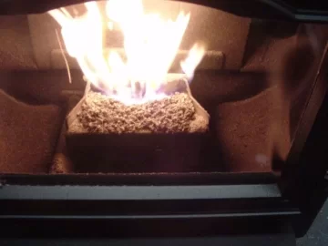

I was running out of pellets and wanted to buy a 1/2 ton to see if I could ride out the remainder of the CNY winter. One dealer was asking $275 for a ton of Dry Creek, and the local TSC was selling pellets for $240 a ton. I purchased a ton of Lignetics a couple of months ago and was satisfied with their product, so I thought I'd buy another 1/2 ton from TSC. When I arrived, they had another brand available - Hardwood Heat. The rating and designation all looked the same - Premium, Hardwood Blend,.5% Fines, Less than 1% Ash, Less than 300ppm Sodium. These were the similar ratings as the Lignetics, so I went ahead with the purchase.
What I've found is that this stuff chokes my P61 and Quadrafire! In the Quad, the burn pot fills to the top with ash/clinkers/unburnt portions within 12 hours! When breaking up the clinkers, it isn't like others as it is a very fragile and breaks apart easily - still the same I have to shut down and clean out every 12 or less hours. In my Harman, the ash piles up then starts to back up eventually choking out the fire. I have to scrape every 6 hours when running at higher temps. I am tempted to try to get my money back on the remainder of bags and try to locate another brand as these burn terribly! I've included a snapshot of the P61 and as you can see the flame is becoming lazy and needs to be scraped again - this is after 4 hours from the last scraping.

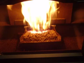

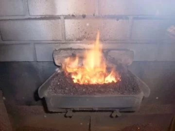

My stove is in maintenance burn right now. And I haven't scraped for 3 days.

When I did the scraping, the burn pot holes were clear. I've been burning this stove - installed new for only a week. When I burned Dry Creek or Energex (or even the Walmart $168 a ton cheapo pellets) this didn't happen. Ash from the burn would blow off the end of the pot effortlessly and I had to only do minimal scraping. Only when I started burning this brand did the ash seem not to "blow off" and the fire backup began.
I just ran the stove dry, and I will clean and fill with a bag of Energex that I have left and I'll let the forum know what happens.
You still will have a tremendous amout of ash that builds up under the burnpot that will choke the airflow a bit. The ash will fall through the holes.
Also if you are not using outside air check the air intake flapper and make sure it is open.
anyway let us know what the pellets do.

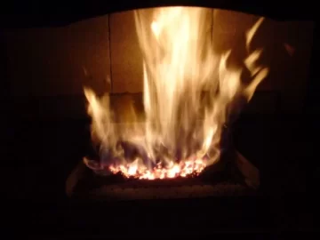

Just cleaned out stove including space under airpot. There was a little sediment, but nothing that would even come close to choking out. The ash that was resulting from the "Hardwood" pellets were like pieces of fused sand. Harder and solid - sized almost like kosher salt grains fused together. This is unlike any other pellet ash that I have seen in the past. I have thoroughly cleaned this out and just installed a bag of Energex and I can't wait to see if there is a difference.
Nine hours later with the Energex pellets and what do we have? A strong flame and the only ash buildup is minimal on the sides of the burn pot as shown in picture. Before I bring the remainder bags of pellets back to the store for refund, I will follow the Energex with a bag of Hardwood to see whether this is a fluke or if it is in fact the brand of pellets that is causing my issue.

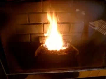

After scraping the burn pot, I then added a bag of Hardwood Heat knowing that by tomorrow morning, I should be burning into that brand by morning. This morning at 5:am what did I find??? It looks like I'm going to be looking to return the remainder of the supply that I bought. :(
This is the first time that I have found such a dramatic difference between pellet brands! Very disappointing....

Well - as I said earlier I added a bag of Hardwood Heat pellets this morning before the Energex was exhausted. in the numerous hours that the Energex pellets burned, there was never a significant buildup of ash. Upon my return this afternoon I found that the burn pot was so filled that there was a 1" hole in a mound of the crystalline ash. That was the last straw and this afternoon I loaded my truck with the remainder of the bad pellets and returned them to TSC. To their compliment - they accepted and gave me my money back with no questions asked. I accompanied my return with a picture of the burn pot filled with ash and they apologized wholly for the bad experience - they haven't heard of any negative experiences so far with this brand. I informed them if they every stocked the Lignetics again, I would be first in line to buy.
