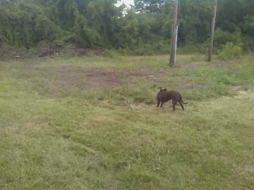

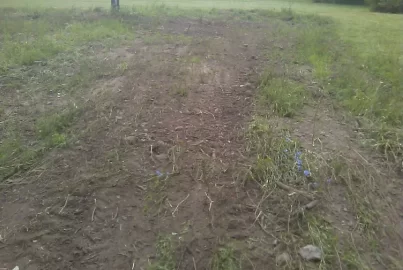

I have been picking away clearing the brush out in the lower part of the yard for a few years now. The idea is to use it for hops and a small orchard. I have it graded about as far as I am going to get with my small tractor and the boxblade mostly because there is little soil and boulders near the surface compliments of the glaciers. I'm thinking that I am going to rake what is left and then bring in top soil to fill any low spots. Is there a better way to make it mowable? I'm pretty sure I would destroy my light duty 3 pt rototiller if I tried it. I've been told that a Harley rake is the right tool but have never used one. Anyone used one with a small tractor?

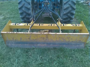

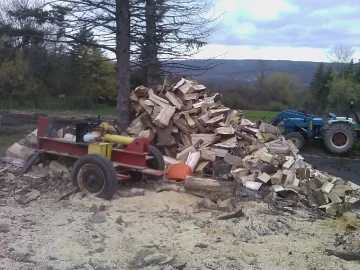

A couple ton 4wd 30 hp at the pto. Cat 1 I think? Hydro flow is low like most older machines so would have to run the rake off the pto.

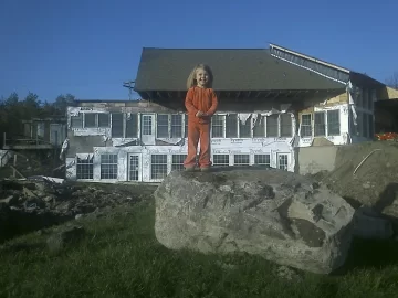

The thing I worry about is how little soil we have and the size of the boulders. This one was barely below the surface where I was digging a drain.

Ja, I have boulders like what you show in that pic too. Plucked some of them when I had a big hoe putting in my driveway and septic field. There are still lots of them that stick up just high enough for the mower blade to hit. The ones that were small enough to remove by hand, I did. Some I beat on with a 12 lb sledge to chip off the exposed top and others I've been raising the grade around so the mower will clear. I beat on them to get a feel for how big they might be before attempting to dig them out.
I would have loved to run over the place with a harley rake to even up the grade a bit and to get rid of smaller roots and stumps, but those boulders are no match for it.
That is my dilemma. I could take the excavator down and dig them out but I think I would just make more of a mess. But, I don't want to me mowing around them for a half century. So, I guess fill it is.
