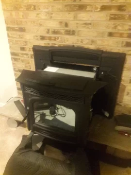

I figured a bucket or stacked pellet bags will do the trick but I almost chopped my finger off so man handling may not be a good idea. They seemed expensive at the time but considering I hurt myself, I wonder if it's not a good idea? Are those kits reliable? Easy to use? Or just a plain rip off?
