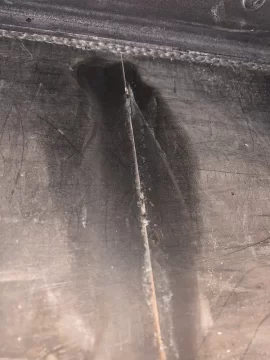

Hi All, I have a crack underneath the ash pan of my Harman Accentra 52i that I just noticed. This is my 2nd year with the stove. Can all you Harman owners and professionals check yours and give me some advise? Thanks , Matt.

Pretty straight for a crack, looks almost man made like a seam would.
Have ur dealer check it. Still under warranty

If warranty denied, I'd Vee it out and weld it and be done with it.

Awfully straight crack. Looks like a seam to me. I second moisture got in it. I'd be calling the dealer too.
Send that pic to your dealer.
Actually that is a seam, you can see the tack welds on it

I'd just use foil tape on it and call it good. It's in the coldest part of the stove so the tape would just insure there's no smoke leakage.
Wire brush it and wipe a smear of black RTV on it or paint it.
