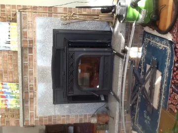

I'm having trouble simply removing the ash lip. I had my stove professionally installed but after cleaning the exhaust yesterday and pulling out a bunch of gunk, I decided it was time to check out chimney flue and remove the fines from the box. I recently bought the expensive rail kit and thought this was a simple matter of pulling out the lip and connecting the rails. It seemed from everything I've read, just pulling the lip straight out from the frame was all that is required as long as the doors were open (so as not to get scratched). I've pulled on it pretty good with two hands and it doesn't seem to budge. I looked for obvious screws and/or attachments -- maybe found some on the side -- but after investigating them, they appear they've never been wrenched which tells me the installer never touched them to latch it down.
Any ideas? First time I'm attempting to pull it out as well.

Hi Cody. I took the brush up the exhaust through the cage and there was a lot of gunk that fell out. That's what got me motivated to open my stove up and put it on rollers. The installer used one of those automated hand trucks to install. I'm not sure what's going on but that lip is immobile. I've tried yanking it out. I've tried lifting it up and yanking it out w/ no luck. It's in there rocks solid and isn't budging. I'll post some photos.

The clips are easy and I understand sliding it out -- you have to give it a solid tug. But before I can do any of that, I've got to remove the ash lip so I can install my rail kit. It's the ash lip that's seriously NOT budging. I saw some bolts on the side behind the doors that may be fastening it to the frame but these screws/nuts showed no sign of wear or wrenching so it makes me think they were never used. But the installer did use one of those automatic hand trucks so maybe he never removed the ash lip in the first place and it came bolted to the frame when it was delivered? No idea.
I suspect it the bolt to the far left in the last picture and a sibling bolt not shown to the far right that's holding it in place.
They should of taken those bolts out. The ash lip should slide in and out freely and shouldn’t have any weight of the stove on it. I would try to use channel locks and back them out or possibly that bolt takes a Allen key in the top?
I just want to be clear we are talking the same thing. I marked the bolts in orange as the ones I'm thinking should be removed. Are we talking the same or are you talking the red ones?
[Hearth.com] Harman Accentra 52i - won't slide out
The orange ones are the bolts that show no wear and tear. So it's probably the red one(s). I'm pretty sure it's one of the two if not both.
I’m thinking the red one shouldn’t be there. When I get home I will look and take a picture.
I'm thinking you are right. I just looked at the installation manual -- and while they didn't say anything specifically about removing those screws -- their diagrams don't show this red screw. Furthermore, the ones I have circled in orange are called Tek adjustment screws and appear to be used for door alignments.
I checked the screw in red and it doesn't appear to be hex so I'm most likely going to try channel locks that you mentioned
But I'm going to wait for your confirmation or somebody else's first. They don't seem to be serving any other viable function.
Yes it is the red one and it pushes that little plate down onto the lip. I don’t even use them.
