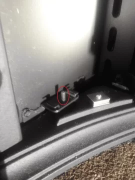

Cool. I see you don't even use the magnets! Thanks for your persistence. Probably is just there to secure the lip during shipping.
Yeah the bolts were cheap and stripped. Still on the list to do lol. Also, good thing you had me open that up. I noticed a lot of insulation, so I will have to see what that’s all about. Never ends

That did the trick. Removed the red screws and it slid right out.

Remove this guy.

Mine looks like this. I have an actual bolt. Not sure what you have in there but you will have to back it out to get that ash try out.
